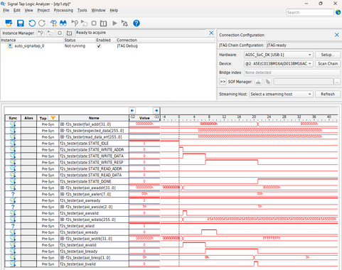

Hi HPark14,
Thanks for the details and screenshots.
Looking at your Signal Tap capture and RTL connections, one item stands out: AWUSER / ARUSER are tied to 8'd0.
For Agilex 5 F2SDRAM, the HPS TRM (Sec 12.2.6.3 AxUSER Bit Connectivity) states that fabric accesses through F2SDRAM should use AxUSER[7:0] = 0xE0.
The Platform Designer f2sdram_adapter IP is also typically placed in front of the f2sdram bridge to decorate AXI transactions, so they are routed and managed properly within the HPS.
Suggested next step:
Please try either:
assign awuser = 8'hE0;
assign aruser = 8'hE0;
or re-instantiate the f2sdram_adapter between your tester and f2sdram_axi4_sub, then re-check BRESP in Signal Tap.

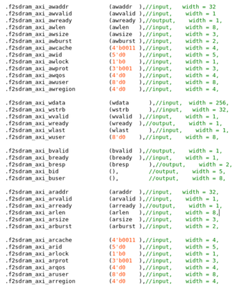

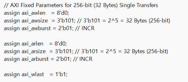

- HPark14
Also I attached my design please review my sideband signals.
