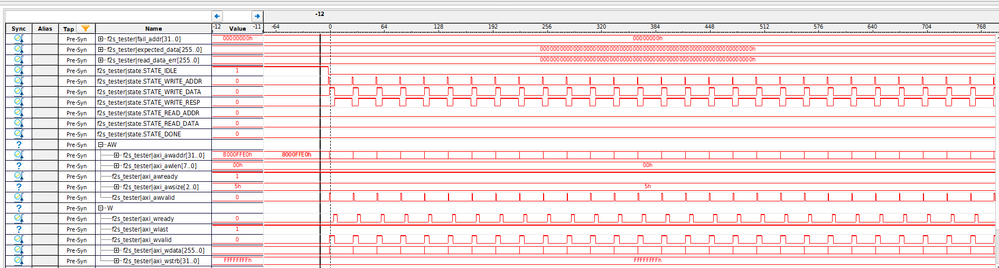

Hi Guys, I am testing the F2SDRAM bridge. 32 bit address, 256bits data. Due to recurring missing Verilog file errors for the Qsys adapter IP whenever switching PCs, I removed the adapter earlier a...
- 2 months ago
Hi Lok,
Thank you for the advice.
I set aruser and awuser to 8'hE0, and it started working properly. Everything has been verified successfully.
Thank you so much for your help. I truly appreciate your support and have great respect for you.
Have a great day!

- HPark142 months ago
Hi Sue
I am using Agilex5 013b HPS f2sdram
