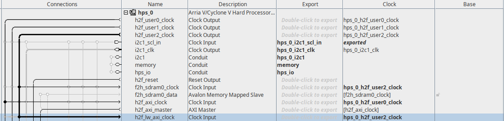

    On the other hand, the one that's used by the lw-h2f bridge in Platform Designer is disabled. I can enable it manually but it doesn't fix the crash.

    I noticed that in Platform Designer, the h2f_lw_axi_clock input signal takes its source from h2f_user2_clock. But the LW H2F bridge clock was &l4_main_clk. So I changed it in the Linux DT (not the overlay), like this:
    &fpga_bridge0 {
    	clocks = <&h2f_user2_clk>;
    I could check the change in the live DT, but it didn't solve the issue.
