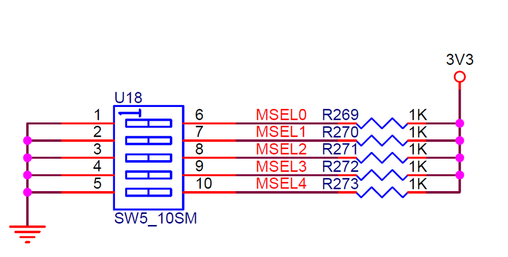

Accdoring to QMTECH_Cyclone_V_SoC_KFB_Dual_SDRAM_Schematic_20240607_V01.pdf,
Please keep in mind to set SW5 for MSEL to ON to represent 0 and to OFF to represent 1.

Hello monkstein88,
Thank you for sharing the photo with us.
Accdoring to a part of QMTECH_Cyclone_V_SoC_KFB_Dual_SDRAM_Schematic_20240607_V01.pdf below ,
MSEL order is opposite compared to your photo.
Here are pin assignments for MSEL.
SW5.1:MSEL0
SW5.2:MSEL1
SW5.3:MSEL2
SW5.4:MSEL3
SW5.5:MSEL4
