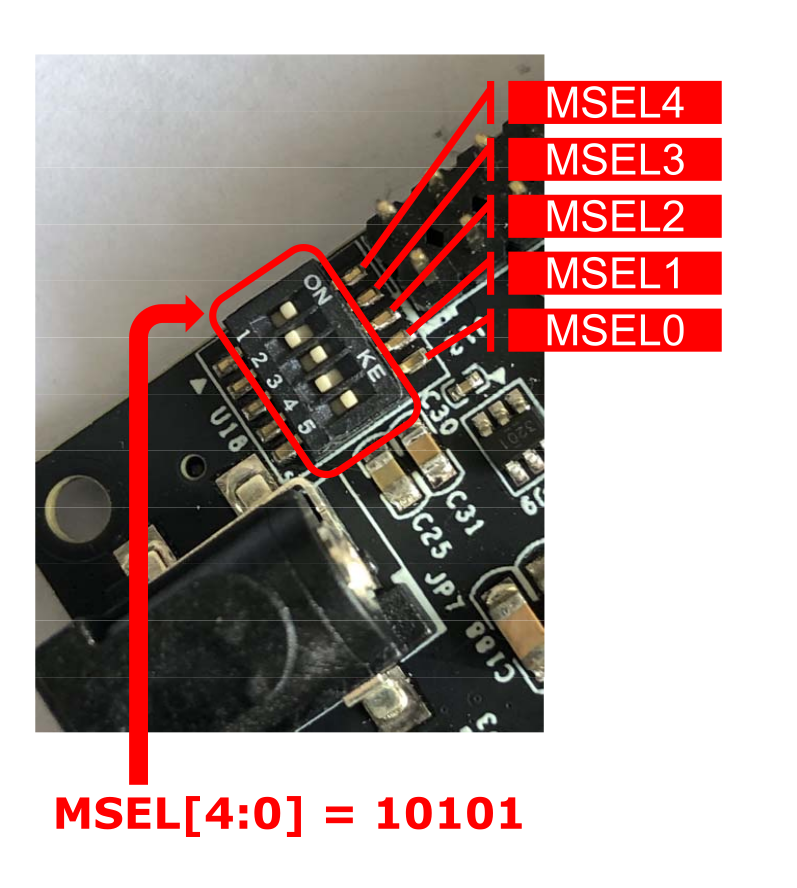

On my side, on my own QMTECH board, I did the check (performed the register read from U-Boot shell) of the 'stat' register of the FPGA Manager Module, and I think I found my answer/reason for my troubles. So I had set MSEL SW to '01010' (ON-OFF-ON-OFF-ON) on my board, stopped at U-Boot, issued the command and got the below:
=> md ff706000 1 ff706000: 00000058 X... =>So, I do NOT get the expected: 'ff706000: 00000050 P...' , but actually 'ff706000: 00000058 X...' . And then I checked my board physically , toggling one pin at a time , and then reading back the 'stat' register after each pin change. And it was found out that one of the pad pins (the PIN.5) of the DIP SW was broken. And toggling the one switch adjacent to that pin, made no change in the 'stat' register readout.
So, I think the cause had been found for why Uboot can't load compressed .rbf succesfully - my board has a broken MSEL DIP SW pin and it just physically cannot apply/provide the MSEL = '01010'. So, I have to fix my board in this case.

Please double check of MSEL setting.
Accdoring to QMTECH_Cyclone_V_SoC_KFB_Dual_SDRAM_Schematic_20240607_V01.pdf,
Please keep in mind to set SW5 for MSEL to ON to represent 0 and to OFF to represent 1.

FYI, I am aware of the MSEL settings for the board :
- but whatever DIP SW combination I try, I always get this error -6 :(
