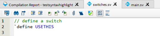

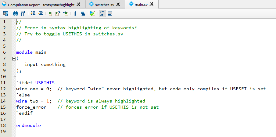

- JoeLUH
Hi sstrell,
yes, that concerns the keywords and also // comments .
These are the two files as visible in editor after full compilation, behaviour is described in the sources:
Since I'm generally using numerous switches in my projects, this bug (if it is a bug) makes my all source codes unreadable for me - so I'm forced to go back to older versions.

- RichardT_altera
I checked 19.1, 20.1, 21.1 and 22.1, it seems to be a GUI issue. I will report this to the engineering team.
You still able to compile the design even if the syntax is not highlighted, right?

- JoeLUH
Yes, exactly. It does compile correctly when setting the switches. Can be tested with the line "force_error" in my above sample code.
