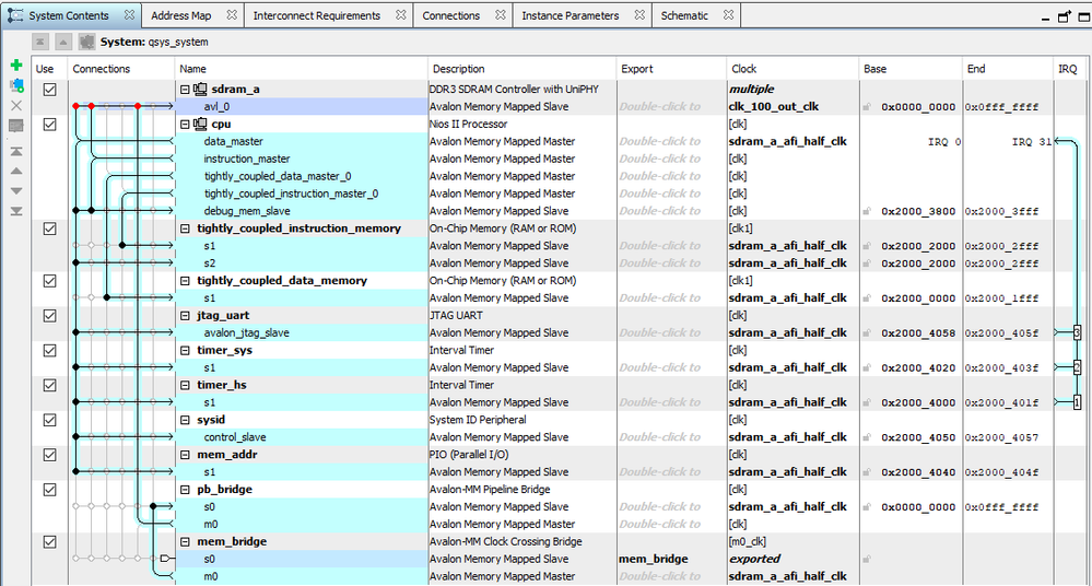

    thank you very much for your suggestion. It work fine and it is much easier with pipeline bridge then what i had i mind. I also added a clock crossing bridge since my logic out side nios doesnt run on the same clock as NIOS.
    I have a system here with Cyclone V and 2G DDR3. There is some other periphery there also but i will leave it out for a moment.
    Here is a picture of my system

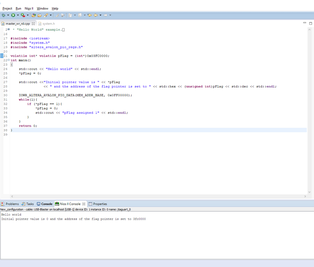

    DDR3 is addressed from 0x0000_0000 to 0x0FFF_FFFF. This is the addressing of bytes, 0x0FFF_FFFF is 268KBytes which makes it 2Gbits. So that is fine. In NIOS software i declare a volatile pointer of int to address 0x0FF0_0000. Further more i initialize the value of this address to 0. When i run my nios software, in the command line i can see that value at the address to which pointer is pointing is correctly setup to 0, and also the address of the pointer is 0x0FF0_0000.

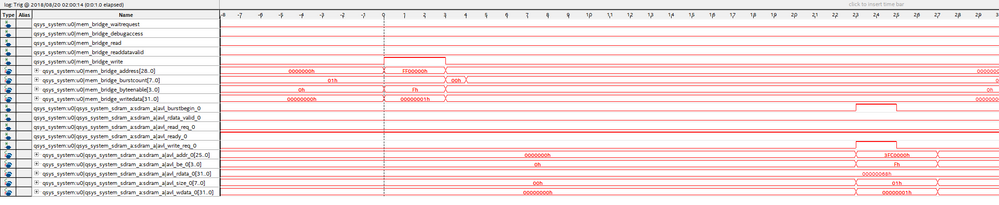

    My external logic is setup such that every second a 1 is written to 0x0FF0_0000. So very second i expect NIOS software to write me "pFlag assigned 1". But that never happens. I tried looking at the signal tap to seewhat is going on
    mem_bridge is the interface port to my logic, while qsys_system_sdram, is the qsys generated logic. From the picture you can see that when signal mem_bridge_write=1, mem_abridge_address=0x0FF0_0000, mem_bridge_byteenable=0xF, mem_bridge_writedata=1, mem_bridge_burstcount=1 and waitrequest is low. Accordig to the instructions those are to conditions for a valid write. About 20 clocks later you can see that simillar signal config is also on the sdram controller. The only difference that i see is in the address. IT looks like the address is shifted to bit down. I figure that is because sdram controller does addressing in 32-bit mode while bridges the do everything in 8 bit mode.
    However i am still out cold. My while loop never gives me a message sayting that flag was set to 1.
    I dont know what i am doing wrong, does someone have any ideas.
