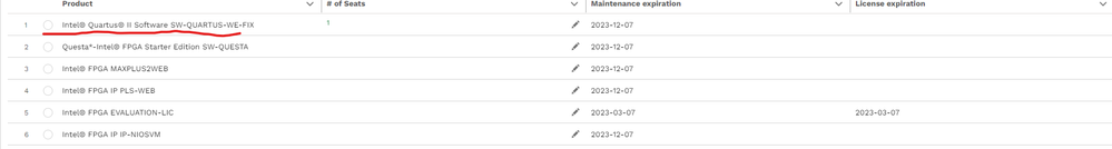

"Sign up for Evaluation or Free Licenses" at the top of the webpage needs to be selected. From there, select "Inter Quartus II Software SW-QUARTUS-WE-FIX"

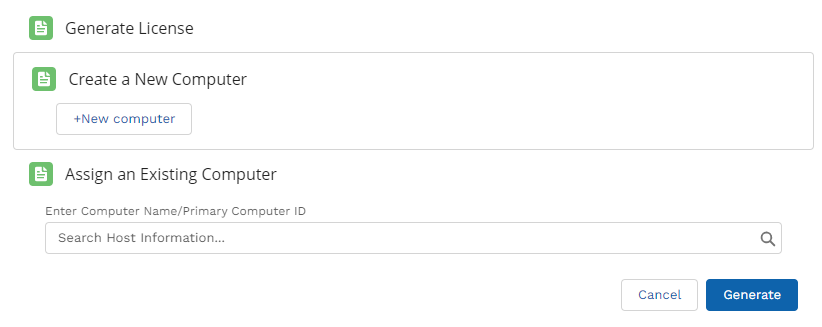

From here, select "+New computer" under "Create a New Computer"

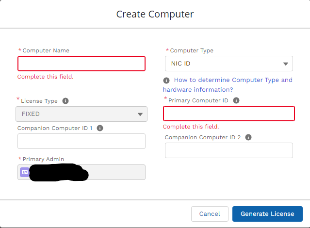

Under "Computer Type," select "NIC ID." For the Primary Computer ID and Companion Computer ID 2 fields, put the physical addresses of the VMware network adapters. These should be listed in the Local System info under the License Setup menu in Quartus.
This will generate a valid license file.
