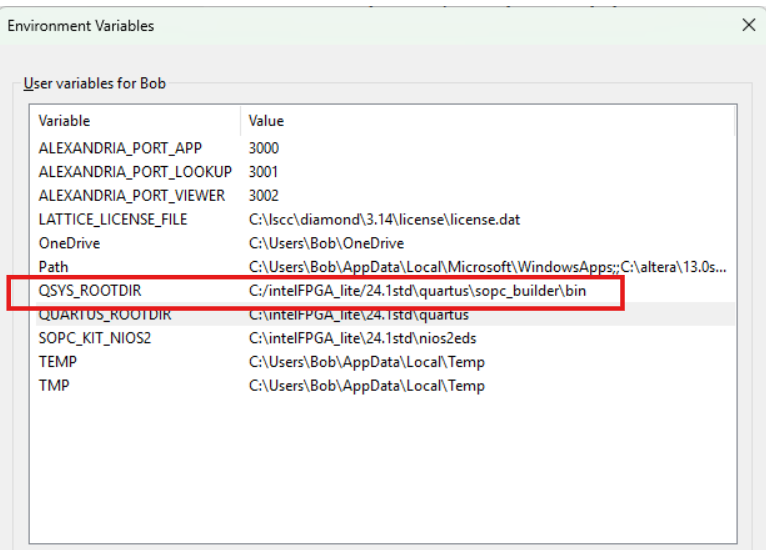

Thank you. I added MGLS_LICENSE_FILE. Here's my environment:
I still get the Fatal License Error when starting RTL Simulation:

I've noticed there's an error in QSYS_ROOTDIR path. Please help to fix the path and try again.

You mean because of the forward slashes? OK. I changed them to backslashes, re-started Quartus, and tried running the RTL simulator. I still got the Fatal License Error.
