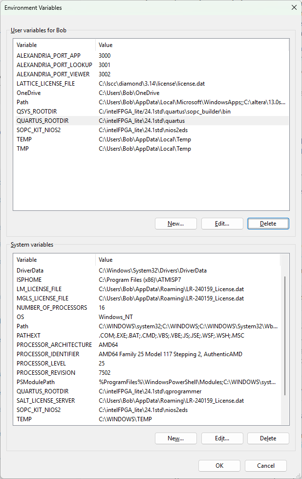

11 months agoThank you. I added MGLS_LICENSE_FILE. Here's my environment:

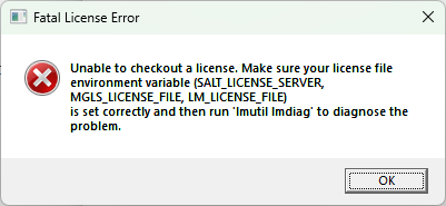

I still get the Fatal License Error when starting RTL Simulation:
