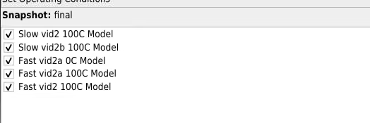

What are the criteria for timing closure in Quartus? Is timing closure required pass all corners as the following figure?
If my FPGA products only work in a server room environment,  the fpga image timing need meet all corner?

    • zjj's avatar
      zjj
      my design timing is clean in all corners by timing analyzer .  for slow vid2 100c model,  If fpga temperature exceeds  100C druing work, the timing will get worse?

    Yes — for timing signoff/closure in Quartus, your design should pass all required TimeQuest signoff corners, not just one corner.
    A few key points:
    • Setup and hold worst cases occur at different corners, so checking only one corner is not sufficient.
    • If your product is only intended for a controlled server-room environment, you may choose a narrower operating range, but then your guarantee only applies within that defined voltage/temperature range.
    • For a robust production design, it is best practice to meet timing for all supported device corners.
    Regarding slow, 100°C:
    • If the FPGA junction temperature goes above 100°C, setup timing will generally get worse.
    • Also, once you exceed the analyzed/modelled corner, Quartus timing signoff no longer guarantees correct operation.
    So the short answer is: yes, signoff should pass all applicable corners; if actual operation exceeds the modeled 100°C corner, timing margin may no longer be valid.
