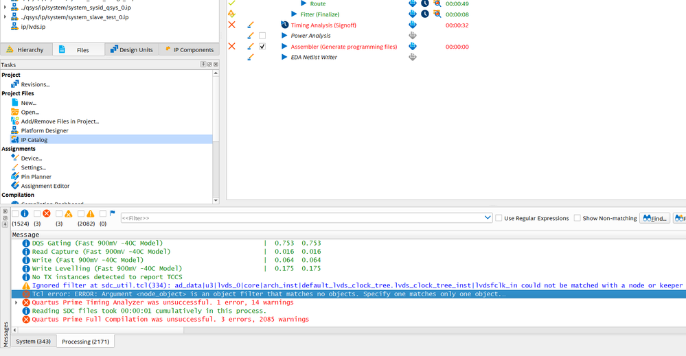

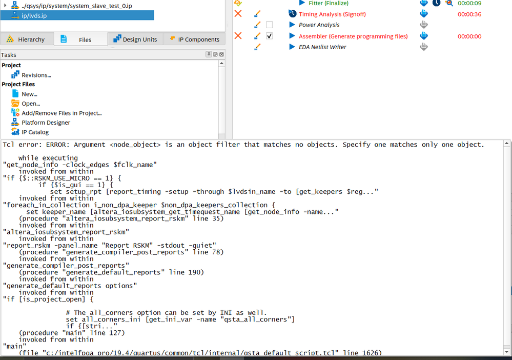

I'm using LVDS SERDES Intel FPGA IP in my project. I use RX Non-DPA. My project compiles almost successfully, except in Timing Analysis. In the end of the Timing Analysis, I got "Tcl error: ERROR: Argument <node_object> is an object filter that matches no objects. Specify one matches only one object.". I attached the image and detail of this error:
This error occurs when I use the generated LVDS receiver in my project. I found an article regarding the similar error. Do we have similar workaround for this?
