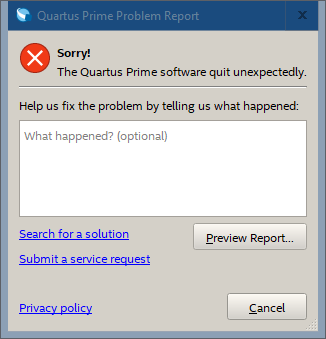

now i can not save the File
Right klick on "untitled1.pof - save File results in
and Quartus closes at all
same Issue like in Standard Edition and not solved for Lite Edition?

- NurAiman_M_Intel
This case is different from the KDB link that you have mentioned. The KDB is regarding examining the data from a CFI flash.
However, this case is examining the data from the internal flash of Max V.
Could you provide the stack trace by clicking the "Preview Report..." button on the Quartus Prime Problem Report dialog box?

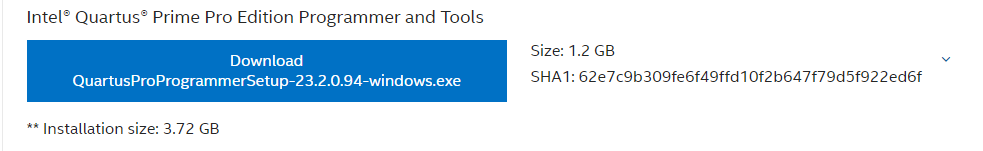

i downloaded the 23.2 Pro Version ( without Licence ) and the QuartusProProgrammerSetup-23.2.0.94-windows
With both the Saving of examined Data works now.
But ISP Clamp is grey out and at File no Box.

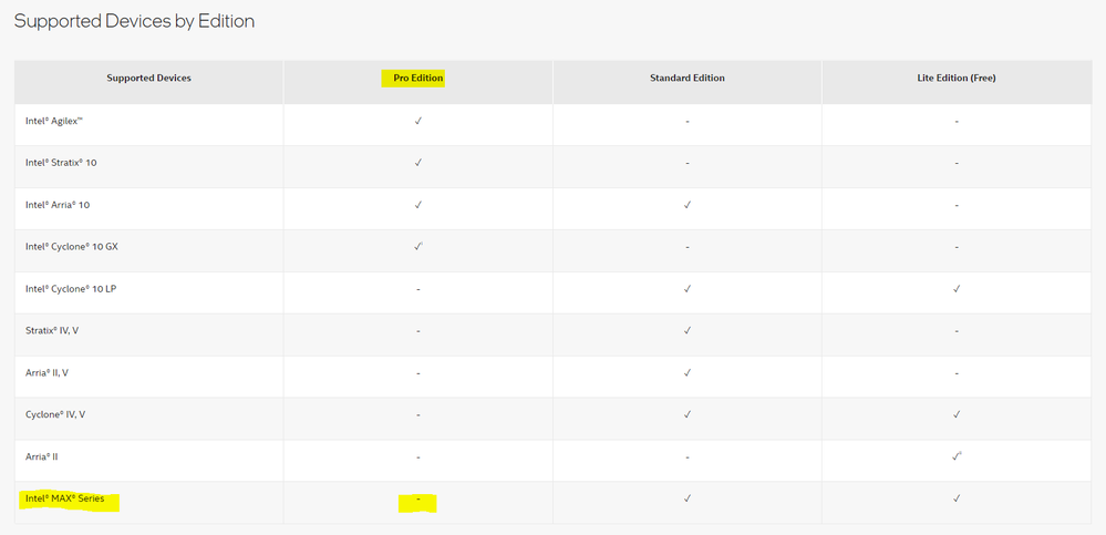

- NurAiman_M_Intel
- NurAiman_M_Intel
Hi.,
As you can see from the picture above, MAX V is not supported in Quartus Pro version. You will need to use Quartus standard version for this.
Aiman

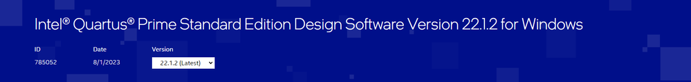

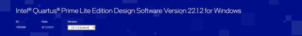

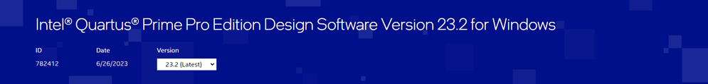

and
no 23.x Versions available
23.x Versions available only for
but the Stand alone Programmer of the Pro Version supports the MAX V
