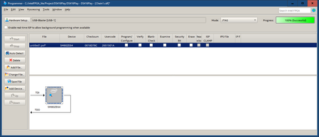

3 years agosaving the examined data of Max V failed --- in the Intel Quartus Prime lite 22.1
Hallo for repair purposes i need to clone Max V 5M80ZE64C5N I do not need to change anything and do not want to programm anything - just need clones. Installed Quartus Prime Lite 22.1 Created a...

TN-Notebooks
3 years agoHallo
i downloaded the 23.2 Pro Version ( without Licence ) and the QuartusProProgrammerSetup-23.2.0.94-windows
With both the Saving of examined Data works now.
But ISP Clamp is grey out and at File no Box.
