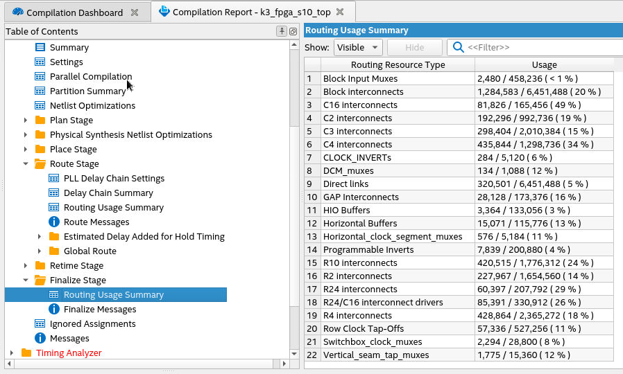

    This should be in the Compilation Report after a full compilation of the design.
  • ALMSlinger's avatar
    ALMSlinger
    Thanks! But all I see is summary.

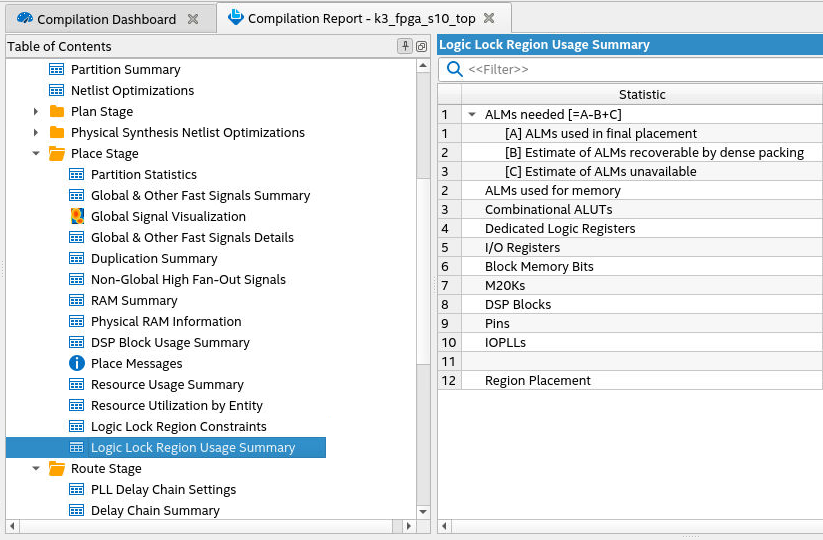

      Hmm... Do you mean this? This doesn't report the route statistics and congestion.

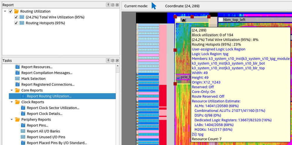

      It would be nice if I could obtain report of what we can see by hovering over the logic logic lock region in chip planner.
      Thank you.

    Unfortunately, we do not have the routing usage report for each Logic Lock region in the 'Compilation Report' .
    As of now, you will need to hover in Chip Planner to check it.
