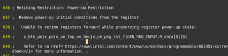

I also see the fast forward compilation report as below:
it still report the power-up state of the register in the scfifo. the fifo is quartus ip, I doesn't know to change power-up state of the register to DON't care.

in the retiming.rpt and fastfoward.rpt, I also see the altera scfifo ip shows power-up restriction as below:
how to fix the retiming restriction?
