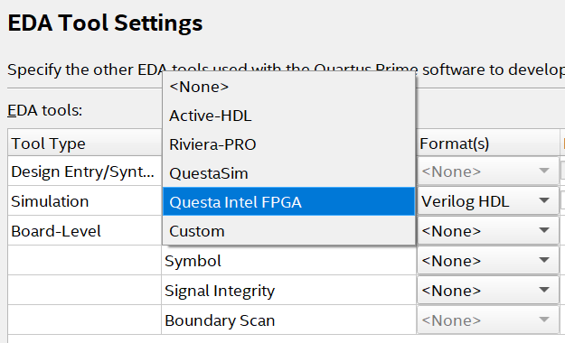

In the past, I used ModelSim for functional simulation.
I just started to use Quartus Lite v.23. During the EDA Tool Settings, do I choose QuestaSim or Questa Intel FPGA?
How do I launch Questa from Quartus?
May I have the link to the documentation on how to use Questa?

  • sstrell's avatar
    sstrell
    QuestSim is the full version from Siemens. If you are using the included Questa with Quartus, it should be Questa Intel FPGA.
