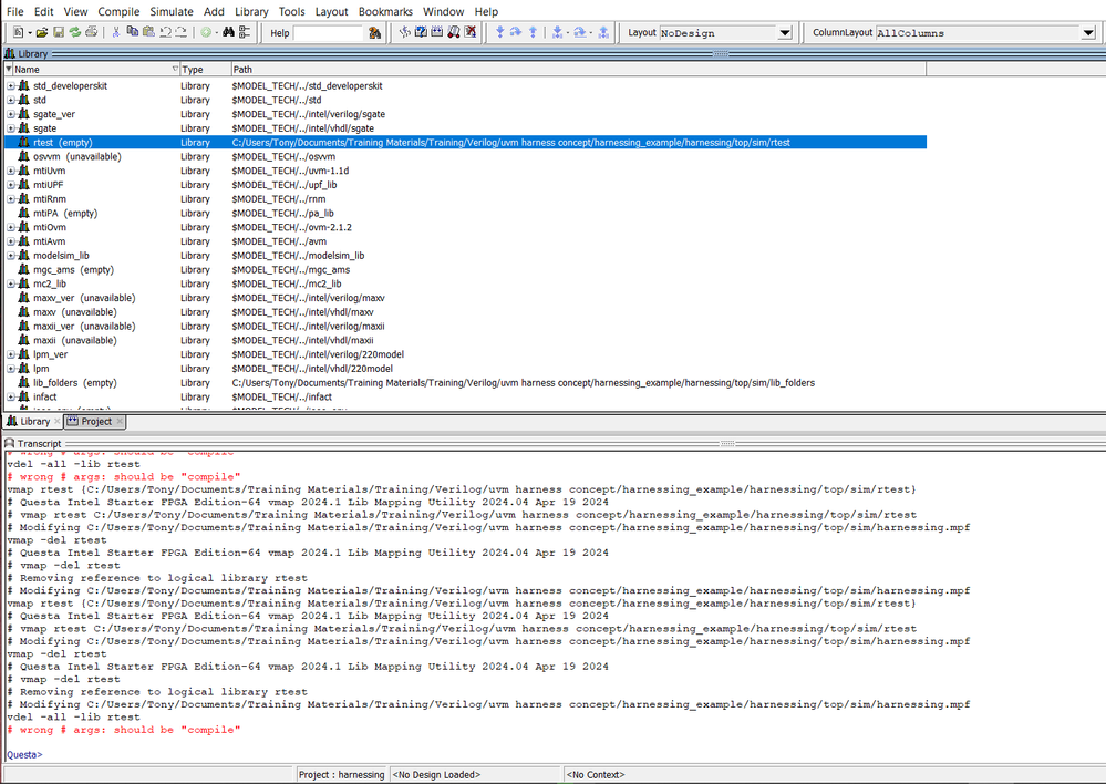

Each time I attempt to use the vdel command (GUI or Tcl), I get the following:
vdel -all -lib tb_lib_path
# wrong # args: should be "compile"

Here is a screen show of the GUI attempting to do the same thing.

I shared the steps in the screen capture. Regardless of how the command is run it fails. vdel -all -Lib name fails in the GUI and in Tcl.
Scripts that I ran in Questasim last year fail as well.
