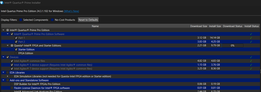

I am facing an install issue, where the installer is unable to unzip agilex-common qdz file.
I have tried multiple ways and it is consistent every time.

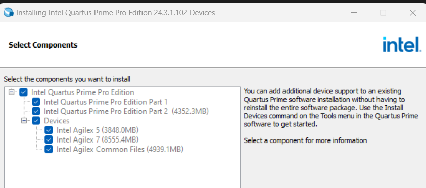

I don't have issue in other files, other components like Quartus Pro, Ashling, etc. get installed. After this, upon launching Quartus Pro, it says no device is installed, and offers to launch device installer. The GUI is unable to launch the installer, and I use "Start->Device installer". Unfortunately, I get the same "unable to unzip error" every time.
I have tried re-download, verifying the checksum, and uninstalling, rebooting and re-installing again.
There is ample storage space in the drive.
I have tried individual downloads of the file(s), using the combined exe GUI installer, triggering the install manually from the download location, and using the TAR package.
I tried trigger the device install manually many times with --unzip_tool option but it still does not work.
I am able to unzip the qdz file manually, but the device installer always fails.

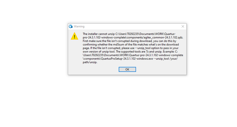

Attached a screenshot of the error message
Kindly guide on how to proceed

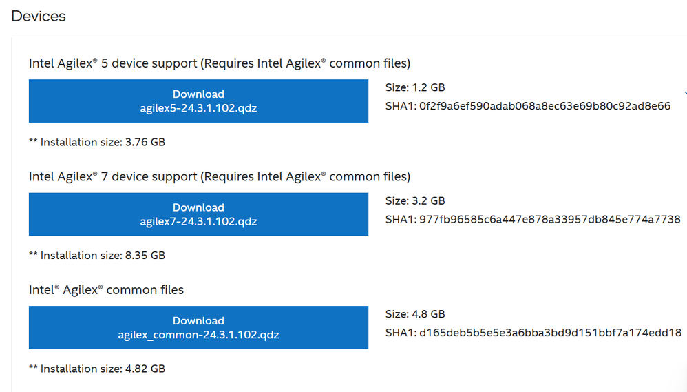

    I noticed you are trying to install the Agilex common files - Intel® Agilex® common files.
    That file is a requirement to install Agilex 5 and 7. Have you try to download and install the Agilex5 (agilex5-24.3.1.102.qdz) or Agilex7 (agilex7-24.3.1.102.qdz) device?
    https://www.intel.com/content/www/us/en/software-kit/845621/intel-quartus-prime-pro-edition-design-software-version-24-3-1-for-windows.html

    As sstrell mentioned, could you try to install the devices using the Quartus Prime Installer?

    Did try all the methods suggested above. I believe the option for --unzip_tool should be used only for the top level installer/launcher.
    I solved the issue, by using the tar files. They throw the same error, but if we invoke QuartusProProgrammerSetup-24.3.1.102-windows with the --unzip_tool, then it worked.
