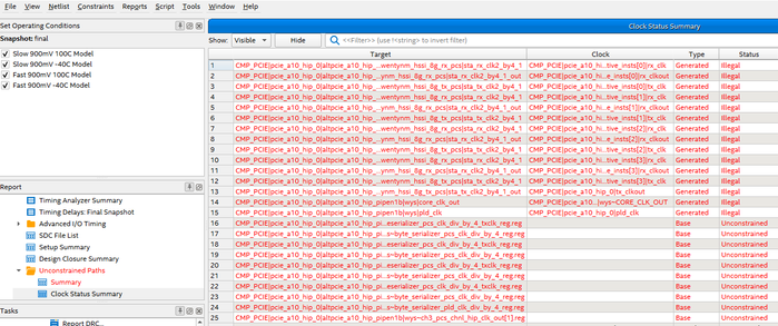

Quartus Prime Pro 25.1.0 Reports Unconstrained Paths in Cyclone 10GX PCIe Hard IP
Recently I have installed Quartus Prime Pro 25.1.0 and recompiled a Cyclone 10GX design that was originally compiled in Quartus Prime Pro 20.1.0. All IP's were updated automatically in 25.1.0. The Timing Analyzer reports Illegal Clocks and Unconstrained Clocks within the PCIe Hard IP. Those errors are not reported in 20.1.0. Are they genuine errors? Can they be ignored?

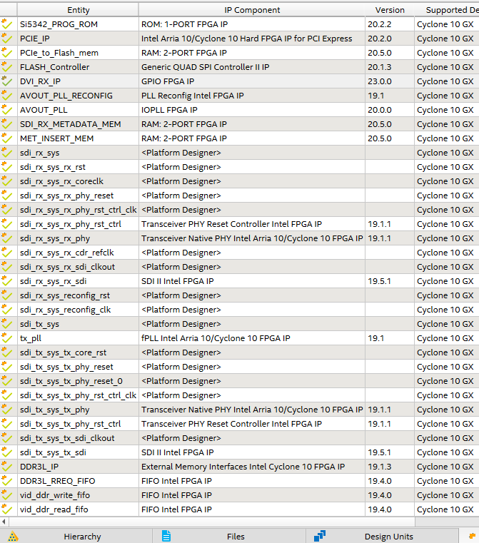

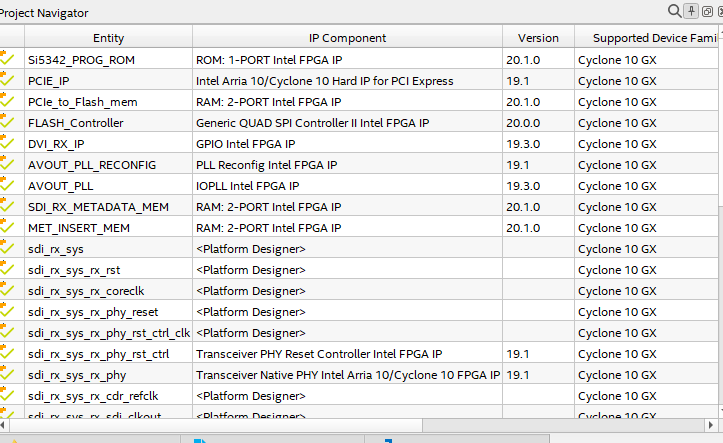

    You say the IP was updated (and regenerated?) automatically. Can you confirm that in the Upgrade IP Components dialog?
    Usually when something like this happens, the easiest thing to do is just recreate the IP with the same parameters as you used originally.
  • WGao1's avatar
    WGao1
    The upgraded IP Components in version 15.1.0 -
    Before that, the dialog in version 20.1.0 is -
    • WGao1's avatar
      WGao1
      Typo. The first image is for version 25.1.0. All IPs are regenerated.

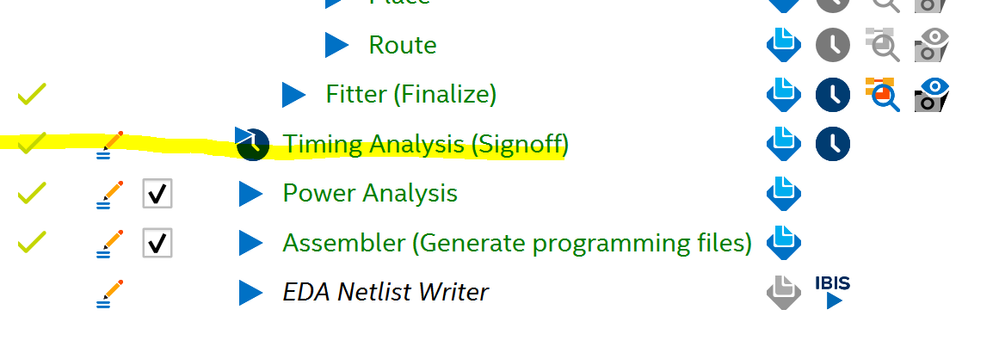

      I suspect there might be errors in the generated .sdc files. The compilation flow shows a green tick before the Timing Analyzer. This indicates the design has passed the Timing Analyzer. I will compare the new sdc file with the old one and see if I can find anything.

        No the green checkmark doesn't mean that the TA met all timing. It just means the TA completed its run.
