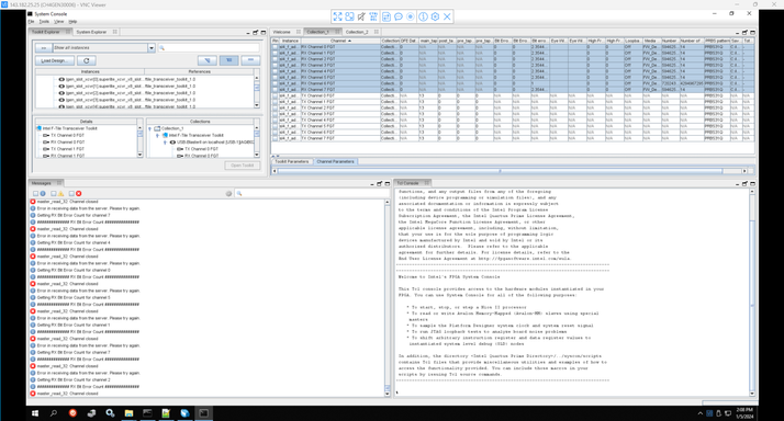

I am using Q23.3 and it throws a "Channel closed" error after running BER test for a while (~5/10 mins). I am running BER test for PAM4 channels.
I have tried downgrading the JTAG blaster speed from 24MHz to 6MHz, but this did not help solve the issue
Please advice. See attached screenshotQuartus 23.3 toolkit

Can you please try with the latest Quartus version 23.4 and let me know if you still face the same issue.

Hi @Kshitij_Intel ,
I switched to Q23.4 and have not seen this issue occurring.
So, yes, this issue can be considered fixed
