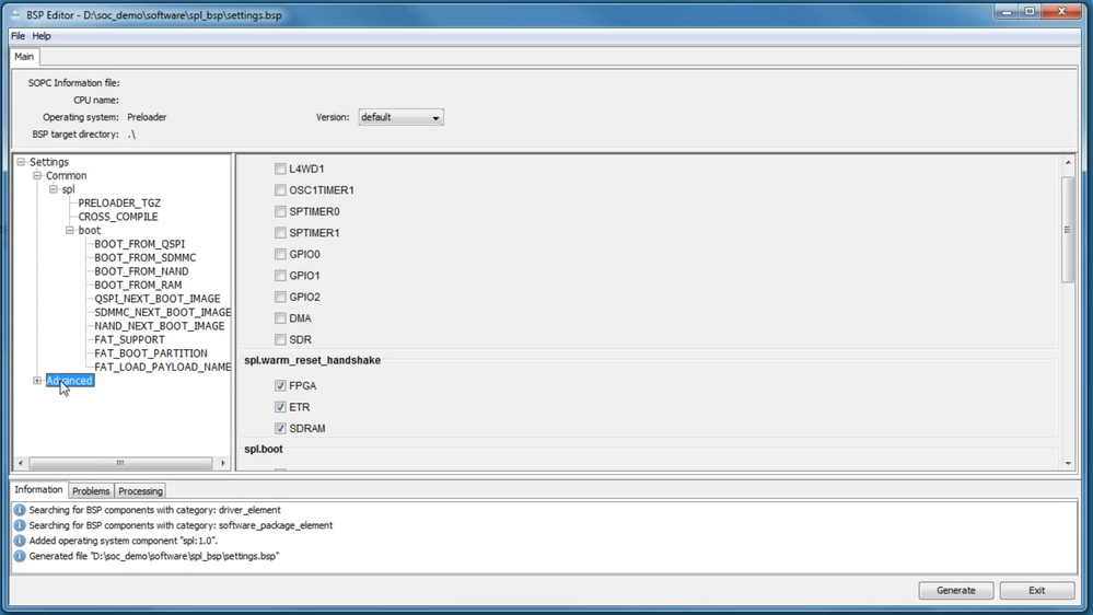

I am using DE10 Nano, and I want to loan IO from HPS to FPGA. I have generated HDL file from Qsys and added SoC_system.v file in my top level file in FPGA.
But I do not know how to custom set the HPS registers in the preloader. I have never added preloader before, so I am blank here. I can share the BSP editor screen shot here. If anyone can please guide me how to link it with Qsys generated file to tell the preloader to set registers according to the design. Because HDL generated file goes directly into FPGA, leaving nothing for HPS preloader to configure. Thanks in advance

    I am actually using Quartus 16. So I loaned IO of Ethernet PHY pins from HPS to FPGA using the .qar file given in below link
    https://community.intel.com/t5/FPGA-Wiki/Using-HPS-IO-in-Cyclone-V-and-Arria-V/ta-p/735656#:~:text=The%20loaner%20I%2FO%20ports,ARM%20Hard%20Processor%20Subsystem%20block.
    Once, I generated my qsys system, I used BPS editor to create MPL by following the instructions given in the video link below
    https://www.intel.com/content/www/us/en/content-details/649272/how-to-build-the-minimal-preloader-mpl.html
    Once generated, I used the the win32Disk Imager and used the facility alt-boot-disk-util.exe to add the preloader .bin file into the SD card.
    When I added the Preloader file, my Linux didn't boot. Which implies that updated preloader was working, as my U-boot might not have run successfully and by Device tree is not updated as well.
    But my main issue is that I didn't get any thing on my receive data or receive packet valid of my TSE IP core pins (I tried sending data over UDP from my PC)
    Also, Ethernet port green light was constant on even if I do not plug in the SD card. Which is weird too that how come it established the Network connection without booting HPS Linux or initialization from FPGA.
    If anyone has any idea, what exactly I am missing in making it work. Please let me know. Thanks in advance.

    From the looks of it the MPL will not boot into Linux.
    It will boot into the MPL and stay there.
    Just to inform you that the MPL software is no longer supported.
    It is advisable to follow the latest version Quartus to build as mentioned in RockeBoard.

      The problem is that I have setup my whole project in Quartus 16. changing it to the latest would be very cumbersome. If you could only help me with the LoanIO of PHY pins, I would be highly greatful to you.
      If MPL stays there, it must have initialized the HPS for the necessary Loan IO configurations.
      If this happens and using the already built project of loan IO for data sending/receiving over Ethernet should work. If you could guide me what part I am missing in this whole scenario which doesn't let me access ethernet over FPGA. Thanks in advance.

    After the MPL loaded, is there an application that interface with the Ethernet port?
    Once the MPL have initialized the HPS IOs if there are no application that interface with the IOs, it will be left as it is.

      Since I have tried loaning IO pins from HPS to FPGA in the QSYS, which in turn is reflected in my updated MPL. So, I am using TSE IP Core in my FPGA side to send and receive the data over UDP. I simply tried if I am receiving anything at my receive pins of TSE IP core (which should be linked with my Loan IO PHY pins). But I didn't receive anything when I sent data to DE10 Nano from my pc over Ethernet using UDP protocol.

    I am having a hard time understanding your connection.
    Could you share me your quartus project?
    Are you running a baremetal project on the HPS ?
