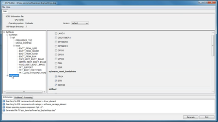

I am using DE10 Nano, and I want to loan IO from HPS to FPGA. I have generated HDL file from Qsys and added SoC_system.v file in my top level file in FPGA. But I do not know how to custom set the ...

The problem is that I have setup my whole project in Quartus 16. changing it to the latest would be very cumbersome. If you could only help me with the LoanIO of PHY pins, I would be highly greatful to you.
If MPL stays there, it must have initialized the HPS for the necessary Loan IO configurations.
If this happens and using the already built project of loan IO for data sending/receiving over Ethernet should work. If you could guide me what part I am missing in this whole scenario which doesn't let me access ethernet over FPGA. Thanks in advance.
