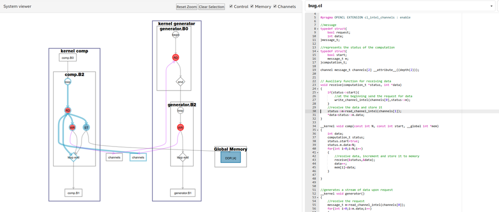

If I try to compile this, the channel operations of the "receive" function are re-oderdered, as can be seen from the report:
This occurs even if there is a clear dependency between the two.
Clearly, if in hardware it is first executed the read, this will lead to deadlock.
This happens with Quartus 18.1 and 19.1 (Stratix 10 as target board).
In you opinion, is it a compiler bug or I have to handle this in a different way?

    I highly doubt the order of channel operations in the System Viewer section of the HTML report follows the actual order implemented by the compiler; the drawing probably prioritizes minimizing space used for the figure, rather than accuracy with respect to order of operations. I would go ahead and just compile and run the kernel to see if it actually gives incorrect results. You can also try adding a barrier in-between the two channel operations as a test to see if the order of the operations will change in the report.

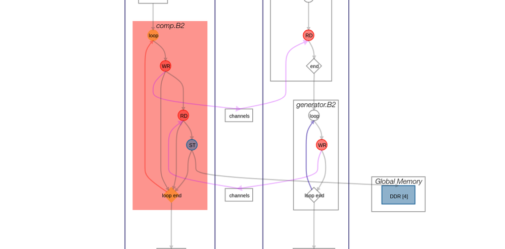

    If I introduce a fence between the two channel operations, they result to be properly ordered, even if the loop II is now 7 instead of 1 (see figure). The compiled version works.
    Still, there exists a dependency between the two channel operations so they should not be arbitrarily re-ordered.

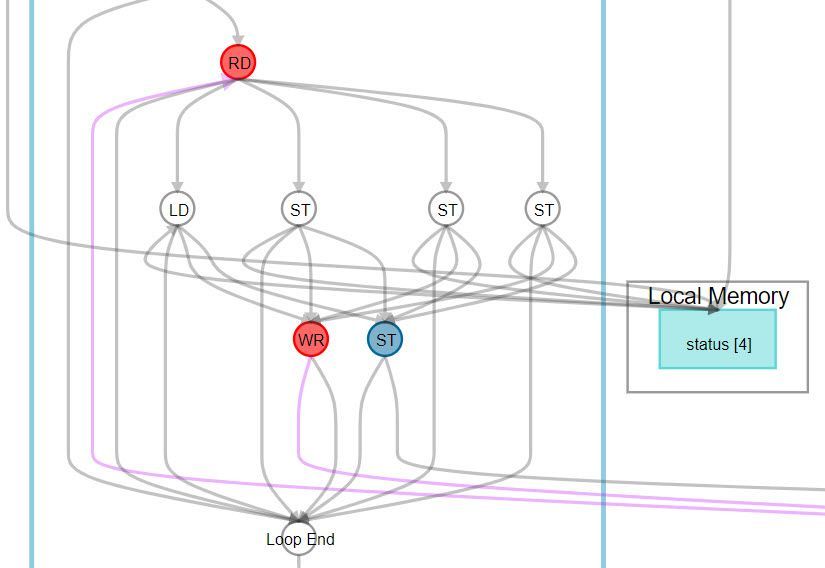

  • @tde m​ @HRZ​ - Yes, you should assume all channel operations are independent even if you think there is a dependency. I know it looks like a read / write dependency on status, but the order that the channel operations are done is not dependent on the read / write order of status. The compiler will order the reads and writes to "status" correctly, but it considers the channel operations totally independent. It would be the same if you were reading or writing to 2 totally different regions in memory. You don't see the reads and writes to status because it's a register. If you force it to a RAM as shown below, it becomes clear. (See diagram)
    computation_t __attribute__((memory) status;
    cycle
    4 - start read from CH1
    5 - read (LD) from status (gets old data)
    5 - write (ST) to status (result from CH1 read)
    12 - start write to CH0 using old data from status

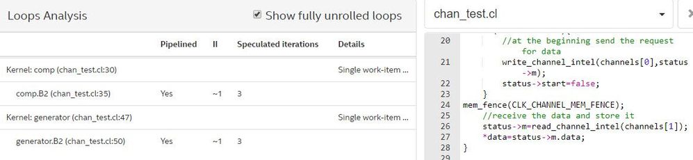

  • @tde m​ I don't see an increase in II when I add the mem fence in 18.1 or 19.1.
    mem_fence(CLK_CHANNEL_MEM_FENCE);
    //receive the data and store it
    status->m=read_channel_intel(channels[1]);

    @douglas.prinn​
    I see the II increase, it jumps to 7 by inserting a fence exactly like you described (it jumps to 20 if the status variable is stored in memory). This is why the diagram was red in the picture attached above.
    Also, if I compile with attibute memory, I obtain a different diagram wrt to yours (I don't have 4 stores, just one).

    • Douglas_P_Intel's avatar
      Douglas_P_Intel
      If I copy and paste the code above and add the mem fence I still see an II of ~1.
