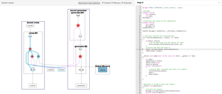

I see the II increase, it jumps to 7 by inserting a fence exactly like you described (it jumps to 20 if the status variable is stored in memory). This is why the diagram was red in the picture attached above.
Also, if I compile with attibute memory, I obtain a different diagram wrt to yours (I don't have 4 stores, just one).
