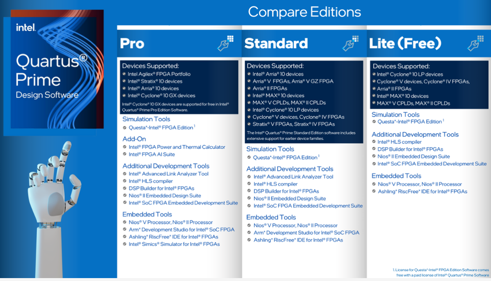

    What version of Quartus Lite are you using? Nios V is fully supported in the latest including the RiscFree IDE (23.1): https://www.intel.com/content/dam/www/central-libraries/us/en/documents/2023-11/quartus-prime-comparison-infographic.pdf
    https://www.intel.com/content/www/us/en/software-kit/795188/intel-quartus-prime-lite-edition-design-software-version-23-1-for-windows.html (under additional software)
    And you should not create any new designs with Nios II. It's gone already in Pro. https://www.intel.com/content/www/us/en/products/details/fpga/nios-processor/v.html

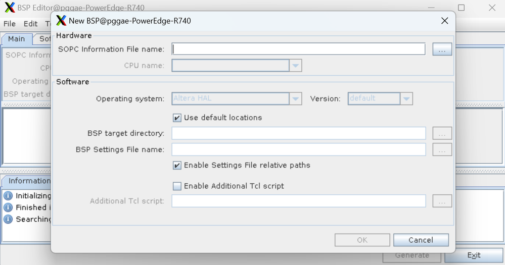

      1) in AN985 in section 1.2.3.1. Creating a Board Support Package, there is a flow to generate BSP, but in my Platform designer, I see no menu option File->New BSP (tested on both Ubuntu OS and Windows 10)

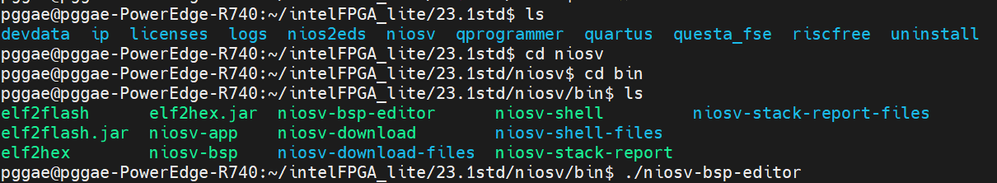

      2) I have tried to create BSP via the command line tool niosv-bsp as described here https://www.intel.com/content/www/us/en/docs/programmable/743810/24-1/niosv-bsp-30520.html#xsf1640875330520__section_tcc_vdx_bsb , but I get "Error: Unrecognized switch <b>p</b>". Even if I tried to generate the BSP as described here https://www.intel.com/content/www/us/en/support/programmable/articles/000096537.html ), I still get errors (I have tested both -p and --quartus-project options).
      From these I concluded that it is a problem of Lite version. I am happy to read that Nios-V is going to be supported.
      Please, do you have some recommendations on verified handbook / manual for Lite version? Is there another trick for niosv-bsp to generate the BSP?

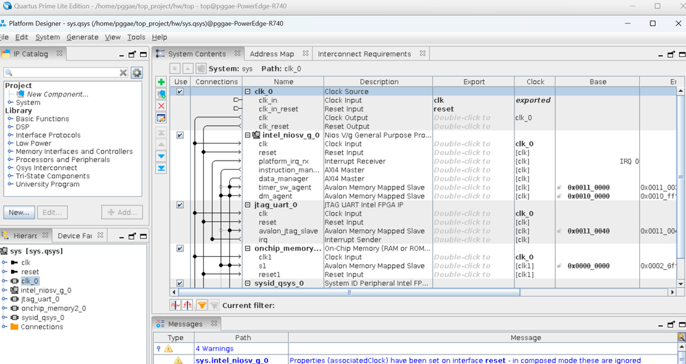

    I've tested on the Quartus Lite 23.1 , it does have Nios V supported. One of the design example that I downloaded from design store
    To generate Nios V BSP, unfortunately it is different from Pro , you will need to refer to this document to do the BSP generation
    https://cdrdv2-public.intel.com/778830/an-778829-778830.pdf
    For reference , you can refer to the Nios V handbook https://www.intel.com/content/www/us/en/docs/programmable/726952/23-4/about-the-embedded-processor.html
