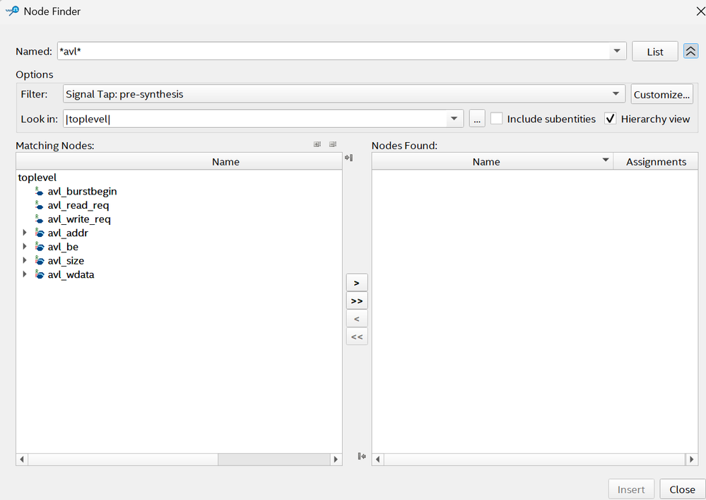

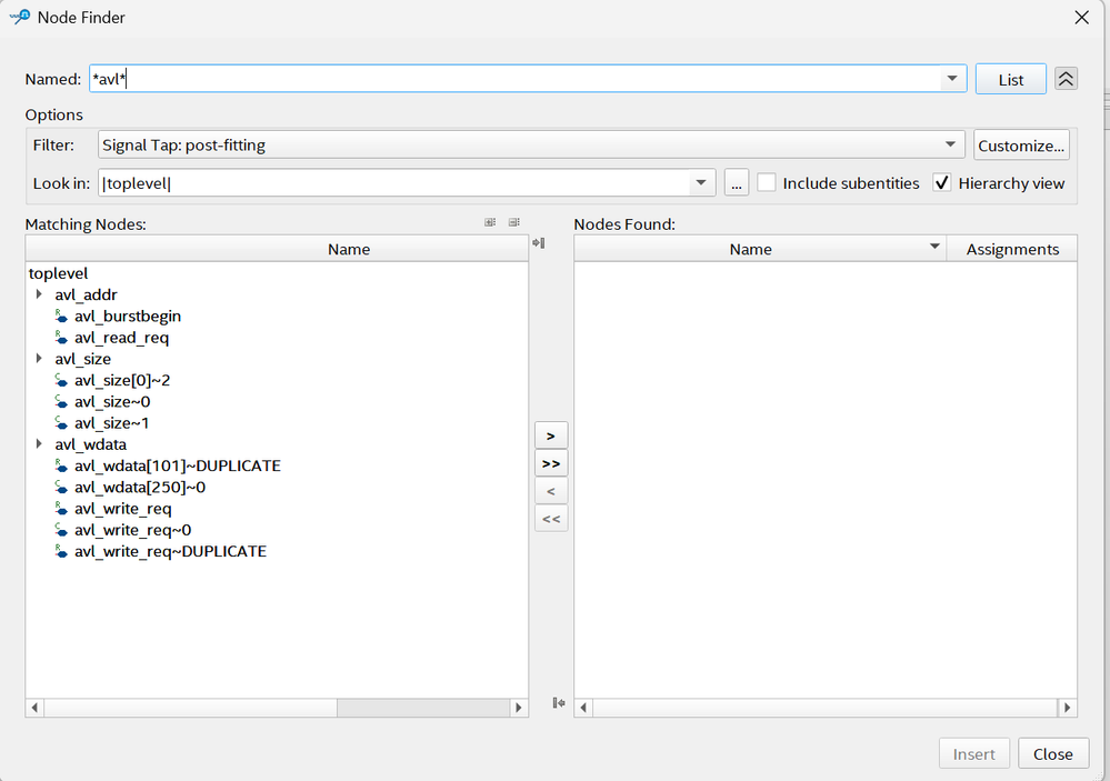

My issue is the the avalon bus signals that are outputs of the IP. Namely, readdata, datavalid, and ready. They do not show up in signaltap neither presynthesis nor post fitting. Signals used as input to the controller which are driven by RTL show up fine.- sstrell1 year ago
ready is not an Avalon signal. Do you mean waitrequest?
Can you show your design instantiation or design in Platform Designer and screenshots of what you're seeing when you try to tap the nodes in Signal Tap? If you're leaving signals unconnected, they may have been optimized away.

Below are the screenshots of the signals that show in post-fitting and pre-synthesis:
- JuanEscobedo1 year ago
Oh and to reiterate, I also cannot use the afi_clk output as the signaltap clock even though the state machine is driven by it and I see the state variable as well as the signals driven by the logic (addr, write data, write req, read req) toggle so it must be present and driving logic.
