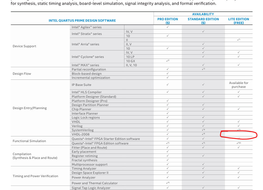

- Quartus Prime Lite Edition
- is supporting Cyclone 10LP & MAX10. (https://www.intel.com/content/dam/www/central-libraries/us/en/documents/quartus-prime-compare-editions-guide.pdf)
- VHDL2008 is supported
- VHDL2019 is not supported
- Quartus Prime Pro Edition
- is not supporting Cyclone 10LP & MAX10. (https://www.intel.com/content/dam/www/central-libraries/us/en/documents/quartus-prime-compare-editions-guide.pdf)
- VHDL2008 is not supported

As per the link that you provided, vhdl2008 is not supported on the Quartus Lite at all and even in the standard version there is limited support for vhdl2008.
According to the documentation the major enhancements for vhdl2008 generics which are used for example in the fixed and floating point ieee packages, are not supported in standard edition
https://www.intel.com/content/www/us/en/docs/programmable/683283/18-1/support-for-vhdl-2008.html
Quartus Pro has support for all vhdl2008 constructs and additionally vhdl2019 interfaces and conditional analysis as per the quartus pro synthesis support documentation

I apologize for any confusion or errors in my previous messages. After carefully reviewing the details, I can confirm that VHDL2008 is not supported in Quartus Prime Lite Edition, which is currently in maintenance mode and there is no plan on the support
Furthermore, I would like to rephrase & clarify my sentence earlier. While Quartus Prime Pro Edition does not support Cyclone 10LP and MAX10, it does provide support for VHDL2008 and VHDL2019.
