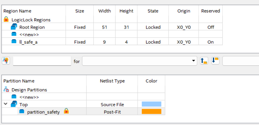

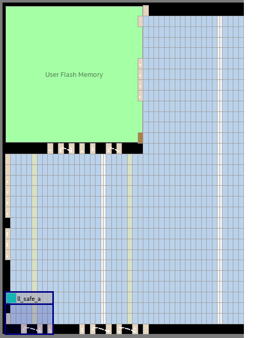

I am trying to create a safety IP partition. First, I have created a partition with a fixed and reserved LogicLock region. ll_safe_a LogicLock region is linked to partition_safety partition. The region ll_safe_a includes some I/O pins.
Then, I have selected the option "allow partition to be strictly preserved for safety" in partition_safety. Finally, I assign the safety pins in Assignment editor. The pins are located in the safety LogicLock region.

It looks like you're not supposed to physically include the I/O pins in the LL region, which is pretty much a common thing for all block-based design flows: https://www.intel.com/content/www/us/en/docs/programmable/683720/current/assigning-i-o-pins.html

All the periphery, IO, PCIE, cannot be logic locked, only core design can be logic locked. usually we locked it for critical module that need timing closure.
