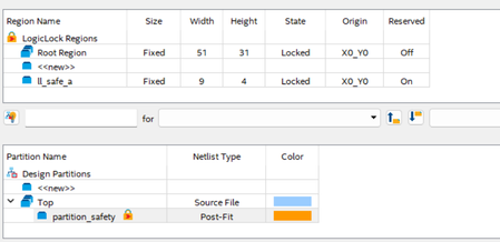

Hello, I am trying to create a safety IP partition. First, I have created a partition with a fixed and reserved LogicLock region. ll_safe_a LogicLock region is linked to partition_safety partition. ...

I am presuming you are talking about the safety flow in AN704, which I had never even heard of!
It looks like you're not supposed to physically include the I/O pins in the LL region, which is pretty much a common thing for all block-based design flows: https://www.intel.com/content/www/us/en/docs/programmable/683720/current/assigning-i-o-pins.html
