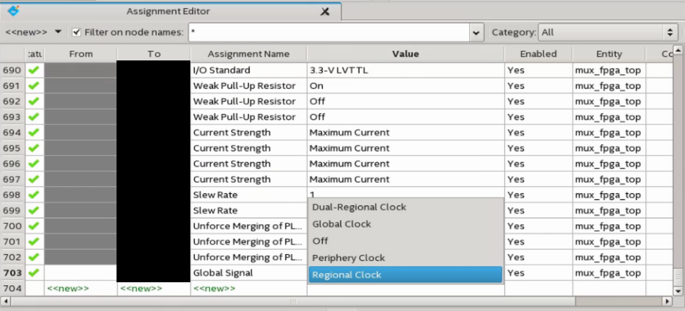

  • KhaiChein_Y_Intel's avatar
    KhaiChein_Y_Intel
    You may set the signal to use Global signal in Assignment Editor. To open Assignment Editor, click on Assignment > Assignment Editor
    Setting the value to Off will prevent the Auto Global options from using the signal as automatic global signal.
    KhaiY
  • EGrom1's avatar
    EGrom1
    Thank you KhaiY, that helped. Sometimes Quartus is a bit of a maze ~:o)
