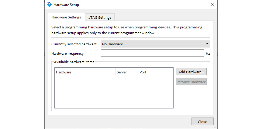

I have installed Quartus Prime on a Win 10 PC. When I use the programmer application it won't recognize the presence of my USB Blaster.
I used to use Quartus II version 14 on a Win 7 PC and had no problems programming devices. The Win 7 PC will eventually not be supportable and I'd like to transfer the functionality to a newer Win 10 PC. However, I can't get Quartus II version 14, or version 15, or version 18, or Quartus Prime to recognize the presence of the USB blaster.

    I am not getting any error messages. I went through the guide including the troubleshooting. The programming tool still does not recognize the presence of the USB blaster.

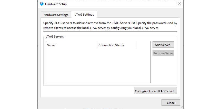

    It still does not see the USB blaster. I have uninstalled all Quartus software and USB Blaster drivers. I then installed Quartus Prime Lite Edition version 19.1.0.670. I connected the USB blaster to the PC. The PC immediately recognized it as USB Serial Port (Com10). I then updated the driver and pointed it to C:\intelFPGA_lite\19.1\quartus\drivers. I then launched Quartus Prime Programmer Lite Edition. It does not see the USB blaster. I also noticed that there is no local server listed in the JTAG setup. Your help is appreciated.

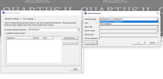

    I have the same issue. Quartus does only show Byte Blaster or ByteBlaster II
    I have uninstall and installed the USB Blaster II many times but Quartus can't see it: Following shows my devicemanage:
    I have reinstalled Quartus many times and have only one installation running, but still have issue with this driver. Please help you support is very much appreciated.
