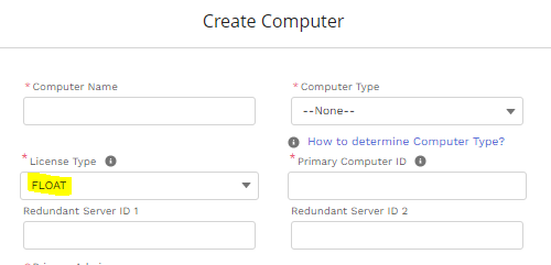

  • Can you share how to create a floating license for multiple desktops?
    I am trying to use Questa starter edition on about 50 desktops and can't seem to get it to work.
    I created a license server. Set the NIC ID of the license server and put that in SCLC and got a license.dat file. But the it is not working.
    Thanks for any help.

      You will need to set the License Type to 'Float' if you want to create a floating license.
      You can check this in the Computers and License Files > All Computers
      Richard Tan
  • Thank you for the reply, but my license is set to FLOAT. Still having the issue.
    Any other suggestions I can try?
