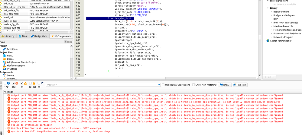

Error(129015): Output port PAR_OUT on atom "lvds_rx_sp|u0_single|lvds_0|core|arch_inst|rx_channels[2
we dont know what happen in agliex-F device to use the LVDS RX IP
Quartus pro 22.4
if we export the LVDS RX IP parallel date to IO this error will disappear.
7 Replies

      Hi@WZ2 and @HongLiang ,
      I'm having a similar compile error on Quartus Pro 21.3 for my project in Cyclone 10. I've set the number of channels to 24 and the serdes factor to 7 in the LVDS IP, but I'm getting the error message below and couldn't figure out why. The message says that the output port is disconnected, but I connected that to another component in the Platform Designer... If you already know the solution, I'd be very appreciated when you share it with me!
      Cheers
      Error(129015): Output port RXDATA on atom "adc_if_0x|lvds_tile|core|arch_inst|channels[7].dpa_fifo.ioserdesdpa.serdes_dpa_inst", which is a cyclone10gx_io_serdes_dpa primitive, is not legally connected and/or configured
      	Info(129016): Output port RXDATA[0] is disconnected, but the Compiler expects this output port to be connected
