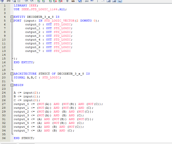

Hi, i wrote my code for a 3 to 8 decoder in structural vhdl :

I never had this error before. I opened the file Simulation_decodeur_3_x_8.vwf.vt and i didnt see any errors. I uploaded the code of the decodeur and the simulation one. Can you help me ?

    i found the error. It seems to be the name that i gave to my inputs and outputs. when i changed "input" to "entree" and "output_0/7" to "sortie_0/7" it worked. i dont know why maybe input and output are key words that i cant use. Hope this helps for the others.

      "input" and "output" are not reserved key words in VHDL, but they are in Verilog, and your test bench is written in Verilog.
