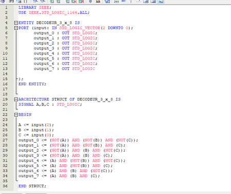

Hi, i wrote my code for a 3 to 8 decoder in structural vhdl : i had no problems during the compilation. When i tried to simulate to see the results, it says : **** Running the ModelSim simul...
Hakim1
2 years agoi found the error. It seems to be the name that i gave to my inputs and outputs. when i changed "input" to "entree" and "output_0/7" to "sortie_0/7" it worked. i dont know why maybe input and output are key words that i cant use. Hope this helps for the others.

"input" and "output" are not reserved key words in VHDL, but they are in Verilog, and your test bench is written in Verilog.
