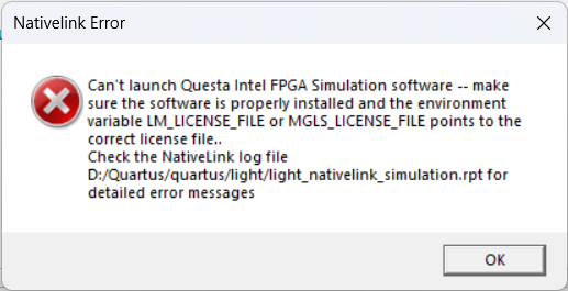

Error: Can't launch Questa Intel FPGA Simulation software.
I'm unable to launch a simulation for a project and I keep getting the following error:
I'm using Quartus Prime Lite Edition 21.1 with a generated free license from Intel "Questa*-Intel® FPGA Starter Edition SW-QUESTA".
Steps taken so far to diagnose/fix:
1. Checked the license is the correct version and the NIC ID matches.
2. Checked the environment variable "LM_LICENSE_FILE" points to the correct file, and made sure the correct file is setup in the Quartus license setup options.
3. Ran "lmutil lmdiag", output shows "This is the correct node for this node-locked license"
4. Re-installed Quartus to make sure I only have the default starter edition installed.
5. Requested new license for the same product and replaced old one.
6. Made sure in EDA Tools, "Questa Intel FPGA" shows as the correct path "C:/intelFPGA_lite/21.1/questa_fse/win64" in my case.
I'm at a loss of how to move forward to resolve this issue. I require this tool to complete a university assignment and my lecturer and the university technicians could not resolve the issue.
Any support would be greatly appreciated.

- AK225
The following is the Error log from Quartus:
Info: Start Nativelink Simulation processInfo: NativeLink has detected Verilog design -- Verilog simulation models will be used========= EDA Simulation Settings =====================Sim Mode : RTLFamily : max10Quartus root : c:/intelfpga_lite/21.1/quartus/bin64/Quartus sim root : c:/intelfpga_lite/21.1/quartus/eda/sim_libSimulation Tool : questa intel fpgaSimulation Language : verilogSimulation Mode : GUISim Output File :Sim SDF file :Sim dir : simulation\modelsim=======================================================Info: Starting NativeLink simulation with Questa Intel FPGA softwareSourced NativeLink script c:/intelfpga_lite/21.1/quartus/common/tcl/internal/nativelink/modelsim.tclError: Can't launch Questa Intel FPGA Simulation software -- make sure the software is properly installed and the environment variable LM_LICENSE_FILE or MGLS_LICENSE_FILE points to the correct license file.Error: NativeLink simulation flow was NOT successful================The following additional information is provided to help identify the cause of error while running nativelink scripts=================Nativelink TCL script failed with errorCode: issued_nl_messageNativelink TCL script failed with errorInfo: Can't launch Questa Intel FPGA Simulation software -- make sure the software is properly installed and the environment variable LM_LICENSE_FILE or MGLS_LICENSE_FILE points to the correct license file.while executing"error "$emsg" "" "issued_nl_message""invoked from within"if [ catch {exec $vsim_cmd -version} version_str] {set emsg "Can't launch $tool Simulation software -- make sure the software is properly installed..."(procedure "launch_sim" line 88)invoked from within"launch_sim launch_args_hash"("eval" body line 1)invoked from within"eval launch_sim launch_args_hash"invoked from within"if [ info exists ::errorCode ] {set savedCode $::errorCodeset savedInfo $::errorInfoerror $result $..."invoked from within"if [catch {eval launch_sim launch_args_hash} result ] {set status 1if [ info exists ::errorCode ] {set save..."(procedure "run_sim" line 74)invoked from within"run_sim run_sim_args_hash"invoked from within"if [ info exists ::errorCode ] {set savedCode $::errorCodeset savedInfo $::errorInfoerror "$result" $savedInfo ..."(procedure "run_eda_simulation_tool" line 334)invoked from within"run_eda_simulation_tool eda_opts_hash" - SyafieqS
