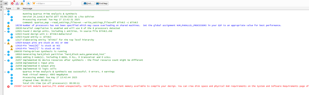

Error (293007): Current module quartus_fit ended unexpectedly
I have been working with Quartus Prime for many years and I teach students how to program FPGAs with Quartus. We use the DE10-Lite board with a MAX10 but also a self-developed board with MAX10. Recently we have had a serious problem.
On some of our computers we can no longer compile even simple designs. I have attached the example.
We get the following error message:
Error (293007): Current module quartus_fit ended unexpectedly. Verify that you have sufficient memory available to compile your design. ...
The error occurs on powerful, newer computers that have 32 Gbyte to 128 Gbyte RAM with Windows 10 and Windows 11. After that, we can no longer fit even the Introtutorial from Altera. We have uninstalled and reinstalled the software. The third time the error occurs again.
On older computers with only 8 Gbyte memory or 16 Gbyte memory we can compile exactly the same design more than 10 times without errors.
The error occurs with Quartus Prime Lite Edition 19.1.0 but also with the latest version 24.1.
We have searched all answers in the community but have not found a solution.
We urgently need a solution, otherwise we will no longer be able to use Altera at the university!
