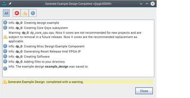

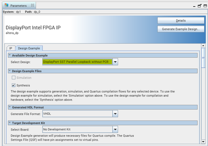

I am trying to generate a DisplayPort example and keep getting an error message, attached. I also am including the settings I am using for the IP. I cannot see what the error message is talking about as I have Synthesis selected as VHDL Simulation does not seem to be supported (as far as I can tell) in Quartus. Any help would be appreciated.

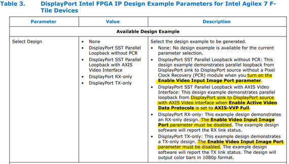

For DisplayPort IP, the are a number of design example available to choose from, you may refer to below table:
F-tile Displayport IP Design Example User Guide
I have tested with the same settings that you use, and I observe there are some setting that you need to turn on in order to enable the design example.
You may enable/disable the settings as mentioned in above table in order to allow the design example to appear on the "select design" option under the available design example tab in IP Parameter Editor.
Screenshot
Allow me to clarify some items below:
Q1. Did you able to see the design example option appear in IP parameter editor as below?
Screenshot1

Glad that you are able to see the design example. If you wish to have a TX-RX design, you may use choose either "DisplayPort SST parallel loopback without PCR" or "DisplayPort SST parallel loopback with AXIS Video Interface" design depending on your desired application.
Below is the example design user guide for your reference:
F-Tile DisplayPort Intel® FPGA IP Design Example User Guide

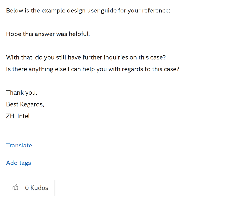

I will do that. I do not see the guide you are speaking of in the message:
Perhaps a glitch? Assuming everything works though, I will not need any more help with this matter.

Yes, I believe so. I think the link might not be updated when I post my reply.
I have already re-insert the link on the previous message.
