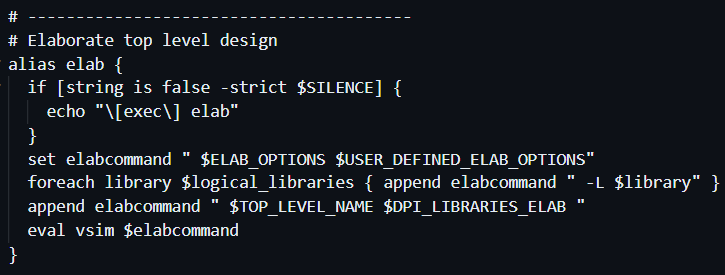

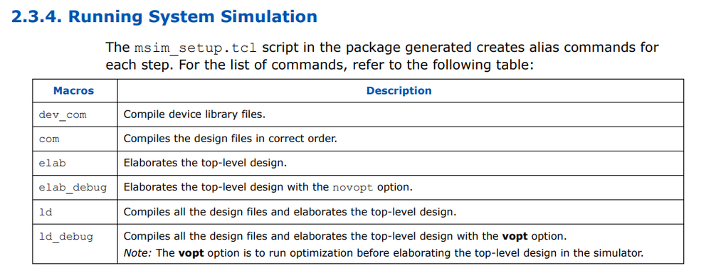

    Based on the documents (AN 985: Nios V Processor Tutorial), there are 2 commands, which are ld and ld_debug. Both of them will calling different simulation flow. Hence, you will see 2 separate instance of the vsim commnd in the msim_setup.tcl.
    Just as a quick update to prevent confusion, the documentation is expected to be revised in the future release.

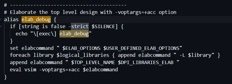

    In the elab_debug section, the statement:
    "Elaborates the top-level design with the novopt option"
    The novopt will be updated to -voptargs=+acc, since novopt is no longer being used.
    Likewise, in the ld_debug section, the description:
    "Compiles all the design files and elaborates the top-level design with the vopt option"
    The vopt will be updated to -voptargs=+acc as well.

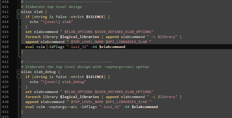

    To answer on your question on which vsim should be modify, based on the tutorial, if you are using ld_debug command, it is an alias that calls dev_com -> com -> elab_debug
    In this case, the vsim command that needs to be modified is the one inside the elab_debug alias. Hence, the updated command will be eval vsim -voptargs=+acc -ldflags "-lws2_32" -64 $elabcommand
    Alternatively, if you want to try on ld command, then you may modify the vsim command defined in the elab alias instead. Then, the updated command will be eval vsim -ldflags "-lws2_32" -64 $elabcommand

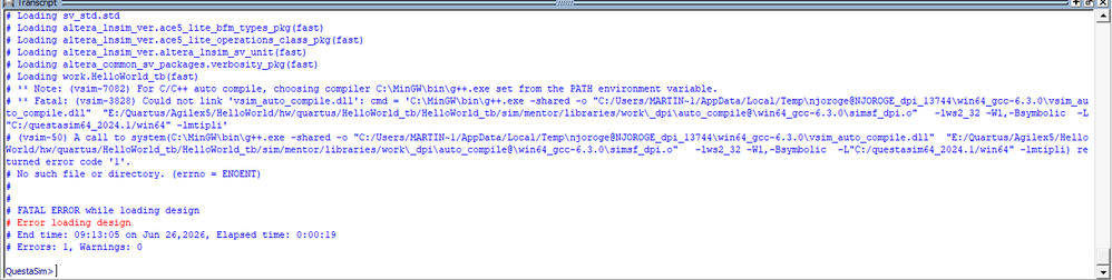

      Hi Njoroge,
      Thank you for sharing the latest log.
      Based on the log, the current issue appears to be that the GCC 6.3.0 compiler located at: C:\MinGW\bin\g++.exe  is unable to successfully link vsim_auto_compile.dll against the Questa 2024.1 libraries. From the transcript, it appears that Questa is picking up this external MinGW compiler from your system PATH rather than using its bundled GCC compiler.
      To help further troubleshoot the issue, could you please provide the following information?
      1. Which Quartus version are you currently using?
      2. Could you check whether your Questa installation includes a bundled GCC compiler? If available, please try using the bundled GCC compiler instead.
      Please look for a path similar to:
      <Questa_install_dir>\gcc-<version>-mingw64<variant>\bin\g++.exe
      For example:
      C:\questasim64_2024.1\gcc-10.3.0-mingw64vc16\bin\g++.exe or
      questa_fse\gcc-7.4.0-mingw64vc15\bin\g++.exe
      If available, please let me know the exact path too.
      3. Once the bundled GCC compiler is located, could you try updating the vsim command to explicitly use it via the -dpicpppath option?
      For example: eval vsim -voptargs=+acc -dpicpppath "<path_to_bundled_g++.exe>" $elabcommand

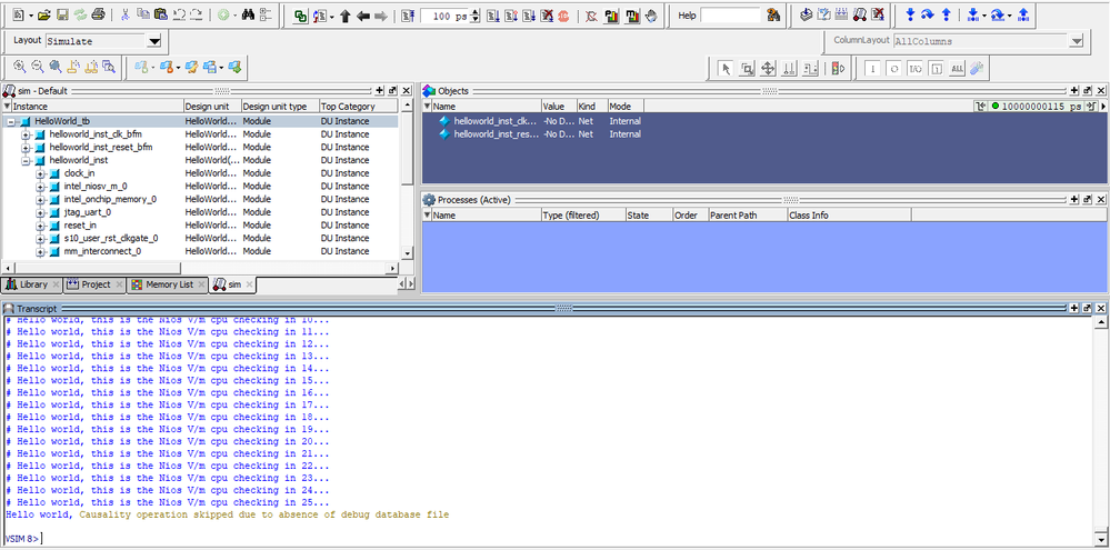

        The solution is actually much easier than that. What I had was the 32-bit Mingw installed. All I did was remove it and install the 64-bit version using msys tools and then set the environment variable to point to the bin folder. It worked right away.
        I am on Quartus Pro 25.3 and there is no gcc compiler bundled with Questasim on my system.
        I believe the problem has been solved so I appreciate the help. Thank you.

      Here's the changes I made:
      Here's the transcript window of Questa after ld/ld_debug:
