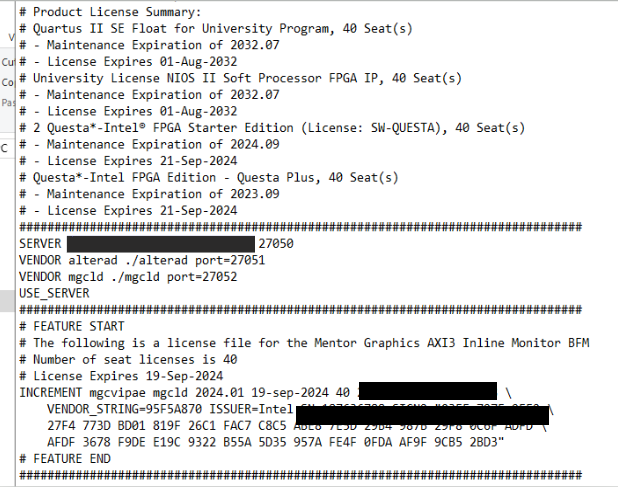

      Thanks for the reply on checking the license path environment variable. The path is set correctly (hasn't changed actually). Additionally, other portions of the licensing file is read and seen within the app when going into the 'License Setup' area. Only have an indication of licensing issue when trying to run simulation. Only thing changed from prior year was that we replaced ModelSim with QuestaSim due to ModelSim being EOL and no longer able to renew the University academic licensing.
  • SyafieqS's avatar
    SyafieqS
    Did you have any Questa license? if you used paid one, you need license, if you use free one also need license which can be generated in sslc. Please verify that since the message is pointing to licensing
    • TrineSYS's avatar
      TrineSYS
      This is just a snip of the initial part of the license file. For giggles I have both the Starter edition and the Questa Plus version licensed as shown in the product summary. The other features in the license file are populating within the application as found under 'License Setup'

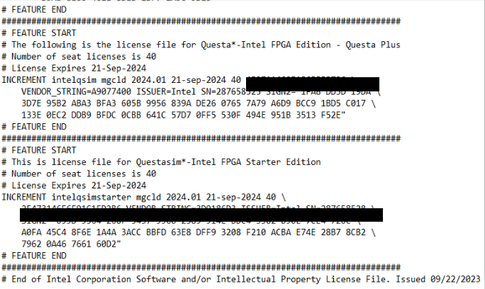

      Also, here is the end of the license file where the Questasim licensing has been included.
