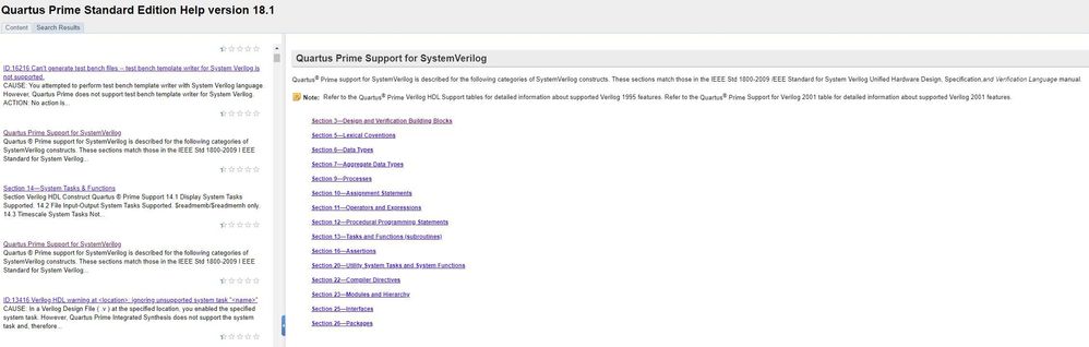

Quartus Standard has limited support in SystemVerilog and you can check the Quartus Prime Standard Edition Help version > Quartus Prime Support for SystemVerilog, for the list of supported constructs.
Do note that you need to install the Intel® Quartus® Prime Help to access it.
KDB Link: https://www.intel.com/content/www/us/en/support/programmable/articles/000097917.html
