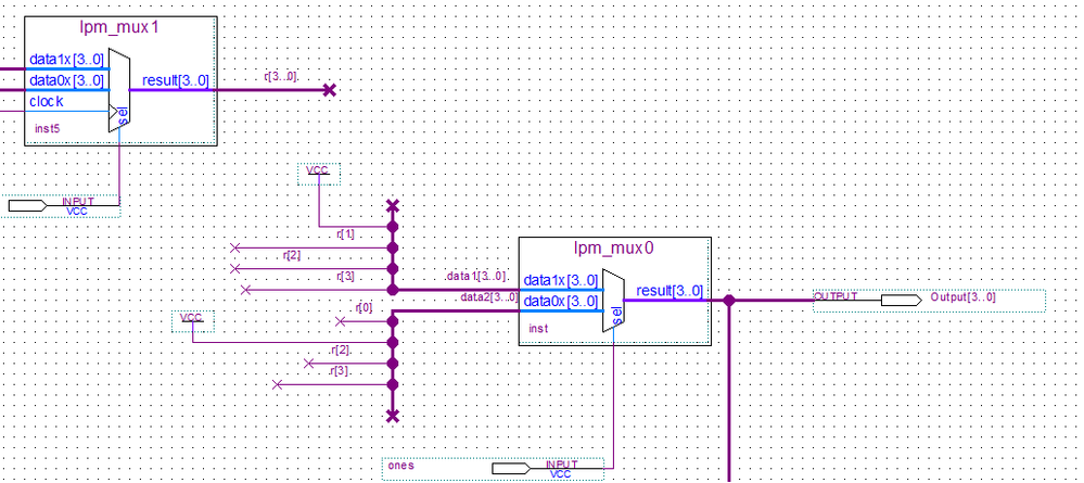

can I select a specific bit of a bus to go into another bit to other bus?
I'm trying to take bits from output to input of the bus .
example : result or r[3..0] = 0000
if my ones selector 0 new output[3..0] is 0001
if my ones is high new output[3..0] is 0010
i tough of making a module that just take input as bus and separate them into bits so i can select what ever i want is there a better way to do it , or what should i do exactly

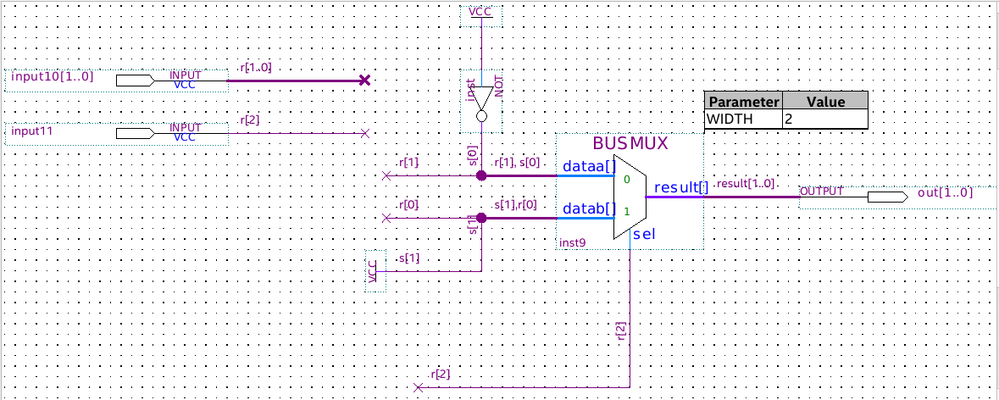

  • Hi,
    For data1x, you have to give a name to the node line of VCC for example s[0].
    Then rename the bus name data1[3..0] to r[3..1],s[0]
    For data0x, same have to give a name to the node line of VCC for example s[1].
    Then rename the bus name data2[3..0] to r[3..2],s[1],r[0]
    Attached a sample screenshot for your reference.
    Sheng

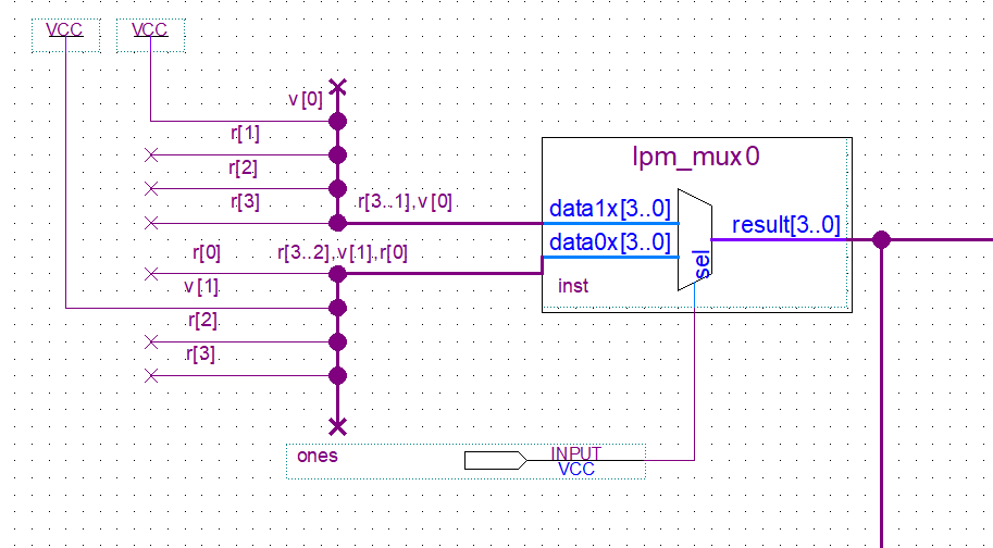

    • MohamedSharfi's avatar
      MohamedSharfi
      sorry i didnt get what you mean but i need vcc to connect with data1[0] and r[1] to data1[1] ... etc in the same order starting top data1[0] untill data1[3]
      same down first bit r[0] to data2[0] .....
  • ShengN_altera's avatar
    ShengN_altera
    Sheng
