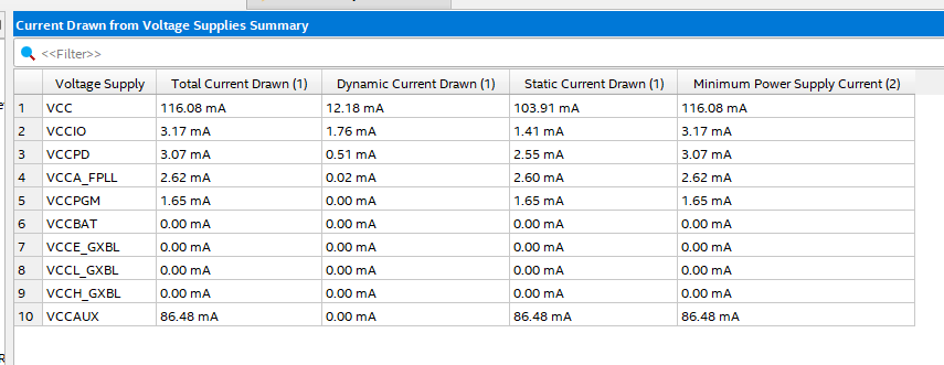

I have never done this before, I used the power analyzer tool in quartus and I got the following table

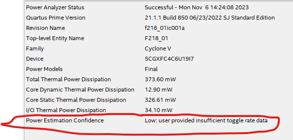

Here is the power analyzer summary and it shows the confidance of estmation is LOW

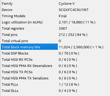

And this is the design summary
For running this tool I only run fitter also I modified the voltage of each bank we have. That's all what I'm done to get the above table, I have zero experience with calculate the power consumption and i don't want to make a mistake. I hope someone here can guide me for the correct steps
