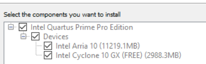

I have installed Arria10 on Quartus Pro 23.4 (see below), but when I am setting a new project using the wizard, Arria 10 is not available from the drop-down Device Family menu. Only Cyclone 10 is there.
What could be the issue?

      I do, but mine is a free eval license that I applied to Self-service License center. I tried reinstalling but still the same.

    I don't think those are the problems because I could install Quartus 23.4 and Cyclone 10 GX as expected. Compilation is fine too. It's just Arria 10 that is not appearing on the dropdown menu, but it is clearly shown in the snapshot it is installed. The same thing happens in Quartus 23.1.

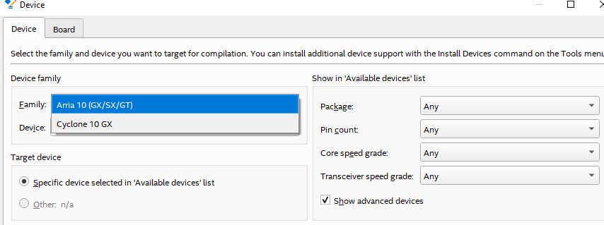

    Yes, I can after reissuing the license. This can be closed now
