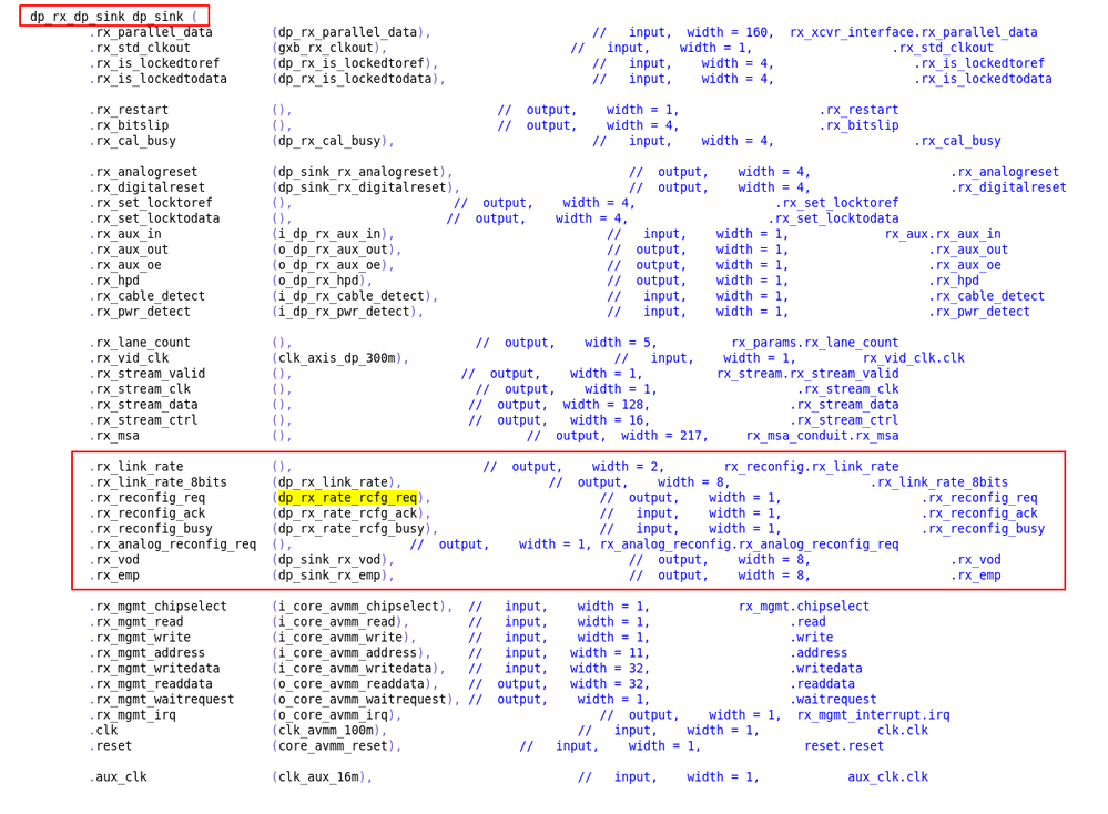

We try to build a DP Rx function in Agilex.
There are some DP RX interface need to connect to F-tile PHY IP
we can not find them in the F-tile IP interface.

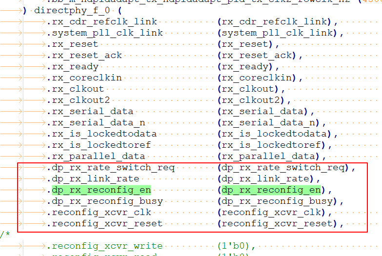

We check the DP example
We found the F-tile IP need to be modified manually for these signals to meet the DP IP.
But the IP is a black box for us, we are not sure it could be modified correctly.
Could any guild doc or patch file help regenerate the F-tile IP for DP RX?

    At the moment, for Agilex device, we have only 2 available design as below:
    DisplayPort Intel FPGA IP Design Example for Intel Agilex F-tile Device
    However, we do have a documentation from another device that you can use as reference to create DP RX design, you may refer to below link for more information:
    AN 900: Intel® Arria 10 DisplayPort 8K RX-only Design - 1.5. Creating the RX-only Design
