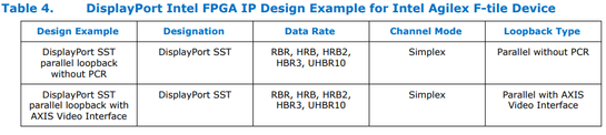

At the moment, for Agilex device, we have only 2 available design as below:
DisplayPort Intel FPGA IP Design Example for Intel Agilex F-tile Device

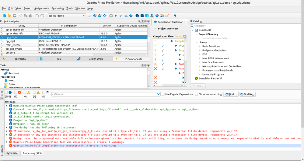

Q2. Did you manage to compile the design? Any errors message or violation?
Yes

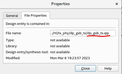

we don't know how to regenerate the F-tile IP
It's not a standard IP file.
