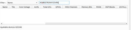

1 year agoAgilex 7 I Series AGIB027R29A1E2VR0
I am trying to use the Agilex I Series Board having the Device Part number AGIB027R29A1E2VR0, containing 1 F Tile and 2 R Tile. The board was bearing the ordering code as DK-DEV-AGI027RES. I tried ...
Ash_R_Altera
1 year agoHi,
The device is an engineering sample part supported only till Quartus 23.2. In order to use the device you will have to migrate to that version.
