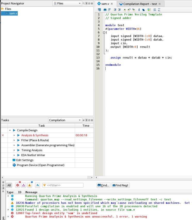

After adding the Verilog HDL File (named "sam") and creating the program
When I compile
The following error appears.
“top-level design entity “sam” is undefined”
Settings → General "top-level entity" is "sam".
Even if I right-click "sam.V" in "Project Navigator" and select "Set as top-level entity" and compile, the same error occurs.
I would like to know how to solve this problem.

Inside your file sam.v, is there actually a definition for a module called sam?

Navigate to the file sam.v. Open the file in a text editor. What is the content of the file? Please post it here.

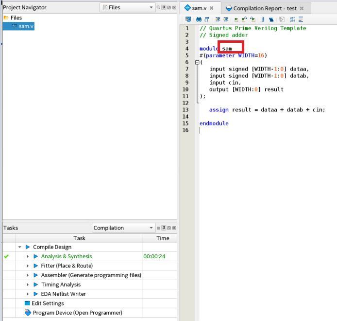

He meant that the module name must match the file name. Please refer to the picture below for clarification.
