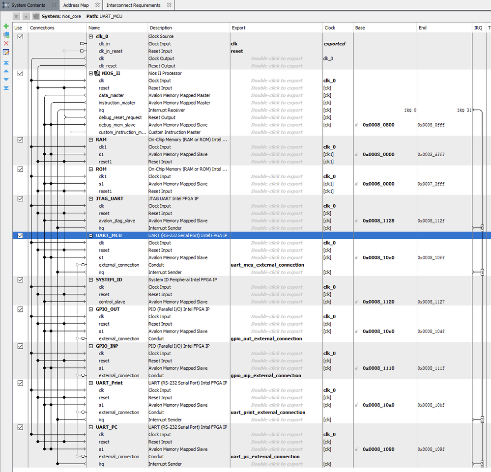

I add 3 UART for NIOS in Platform Designer. please see the following picture.
The questions are:
1) how to specify which UART is for printf?
2) if I use the API IOWR_ALTERA_AVALON_UART_TXDATA to sent out data, how to specify which UART is used in this API?
